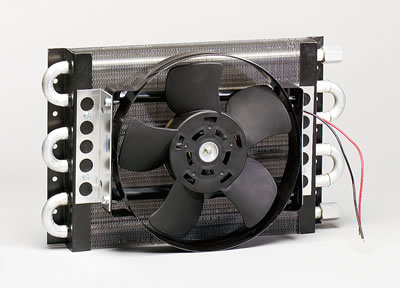

I've dropped the abs entirely and i'm trying to figure how i'm going to fit all the coolers in the engine bay, so I'm thinking I'm going to go with A/A up front and reroute my oil lines through the in-radiator oil and trans coolers, then put in a trans cooler where the abs block used to be ... and probably either louvre or cut-and-screen the wheel well below it to allow better air flow.
Like this cooler (10.5 x 18 x 4, 1250cfm)
From what i remember of my truck when it was in one peice, without the stock air box there was pretty decent space lengthwise, and i could pull 10.5" width wise.... too bad I don't have any good pictures of the block itself
