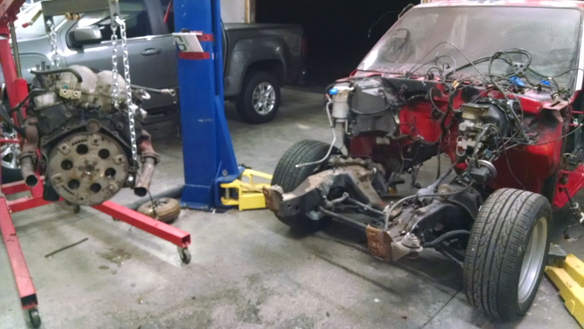

More progress. I went ahead and pulled the motor last sunday after my usual trip to smith creek. Lori was riding the mule, so I got bored.
The transmission is out and at Dale's shop for a rebuild. I will also get him to get me a TC. Had to order the input drum reinforcement kit from Pro Built.
New motor from Aaron arrived yesterday and I picked it up from Fastenall in Tallahassee. Everything looks good, and I am ready to start tearing it down.
I removed the main wiring harness, and will begin cutting it down for use with the Holley HP. Next is to paint the cowl.
More to come.

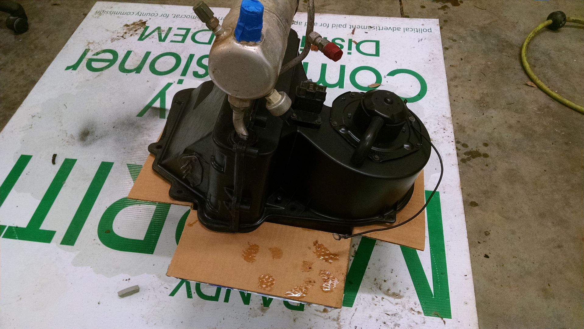

It was cold last night, so I spent some time in the shop and took the a/c box apart and cleaned and painted it. There were so many leaves in it, it's amazing that it blew much air at all.
