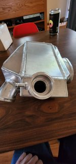

I ended up getting a new one made from Radiator Technologies in FL. It's 1/3 bigger and the filler neck is Now the same size of a Radiator filler neck to make things easier when filling and finding another cap if needed.

Winner ...winner chicken dinner it has arrived! It weighs very minimal...excellent work...absolutely gorgeous 😍.

Looks good. Really interested to see if there is any noticeable different over the stock one. Or if there is any real way to check that without the old one currently in there to run temps or anything.

Old one was leaking* no way to test. Now has become wall Art/ paper weight. I could only give data on new one after install. It truly is a work of Art. Thanks again Radiator Technologies!
Looking forward to post-install photos (if you do not mind). It looks like the new unit might be a bit shorter vertically and that the TB flange has moved forward a bit compared to the stock unit. Both of which I would have asked for to achieve more clearance around the AC.
Did they also make/source the oval TB flange?

I spoke to them about it briefly. Asked for specs compared to the original, but he did not have the new one anymore and only had the original so couldn't get side by side pics. Supposedly, about 30% more efficient due to a different core, but I have no idea considering there are no real world tests done on it compared to stock. He said the core was a newer design for what that's worth. I also asked about adding AN fittings instead of the standard for coolant in/out.
