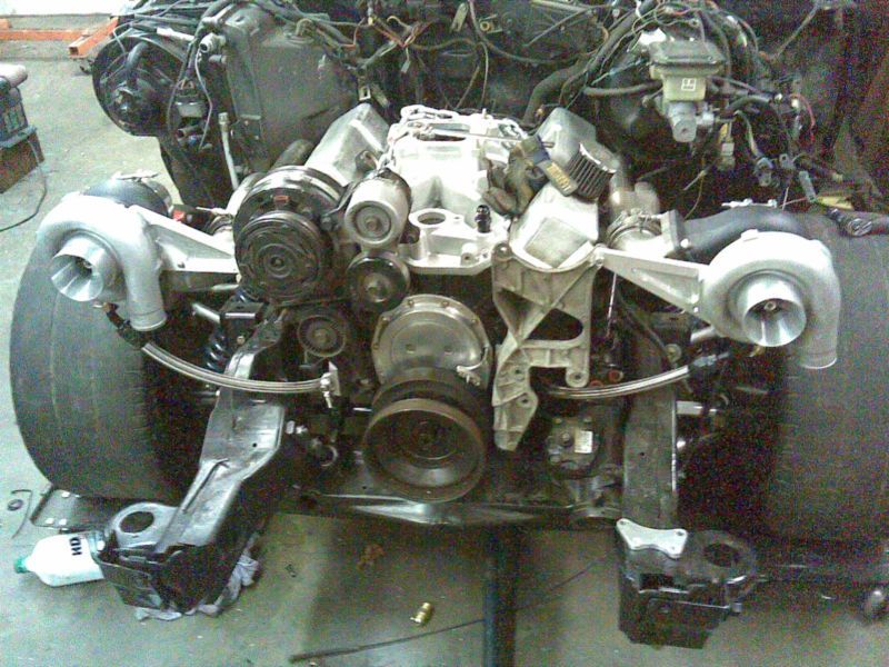

two questions:
what heads are you using?
do you think those turbo brackets are neccessary or just a good "extra" to have? It hard to tell in the pictures. I like them regardless.
Re: Project Never Ends
SeattleSy#1255 said:
two questions:
The heads are old 041x castings. Not great but not the worse head either. The motor was never built for turbo's in mind originally, but I had it laying around from past projects and figured why not. If it blows up we will just go bigger.
Yes I think brackets are needed. Headers should not support the weight of any turbo. Sure they do that fine when cold, but heat headers up to 1500 deg and the strength of stainless starts to go down quickly. Now put 20lbs of crap on it (turbo) and things start to happen. Ever wonder 1 reason why headers crack? 321 stainless is a bit stronger at high temps but not the total answer either.

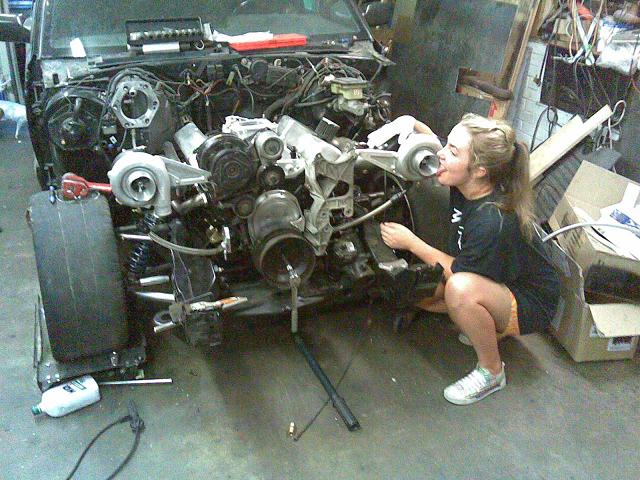

Daron is just jealous.
I had the GF over today helping on the ty. I have her convinced it needs to be done for nats just as bad as I want it done.
